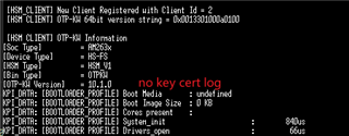

For some reason, I need to integrate keywriter function to my project. After intergration, it didn't work as expected. Below is the result comparision between sbl_keywriter demo project and my sbl project.
sbl_keywriter demo project log:(as in trial run mode,result is as expected)
my sbl project log:(in trial run mode,expected same log with sbl_keywriter demo project, while the result is not)
As shown above,in my sbl project, the hsmRtFw is loaded the same with sbl_keywriter demo project, and I initialized the device the same as sbl_keywriter demo project did. It seems that in my sbl project, after HsmClient_keyWriter() interface passed certificate to hsmRtFw, hsmRtFw didn't work as expected. There is no Validating certificate log and the reseult in variable certHeader.debugResponse is not right.

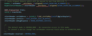

    Thanks for your response. I agree with your opinion that it looks like the certificate is not passed correctly. And I rechecked the code of passing key certificate at my end. It's quite the same with sbl_keywritter demo project. The only difference is that gCustKeyCert in sbl_keywritter demo project is placed in .rodata.custKeyCert section, while gCustKeyCert in my code is just defined to aligned(CacheP_CACHELINE_ALIGNMENT), not particularly placed in certain section. The return value of HsmClient_keyWriter() interface is SystemP_SUCCESS.
    The certificate in my project is the same with the one used in sbl_keywritter demo project (which already tested to be valid in above log), it's not likely an invalid certificate passed.
    I wonder why the certificate not passed correctly, below is my code.
    Is there any potential issue not recognized in the code? Looking forward to your reply.

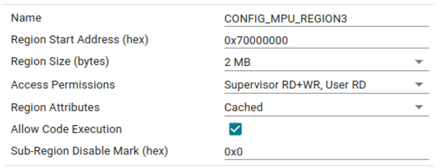

  • When I checked the linker file, The gCustKeyCert is placed .rodata.custKeyCert which is in L2 OCRam location named as HSM_RT and in the MPU configuration, this region is cached
    In your case, could you check where is the certificate placed in your case?
    Can you check if the certificate is placed in TCMA or TCMB region of R5 which is not accessible by HSM?

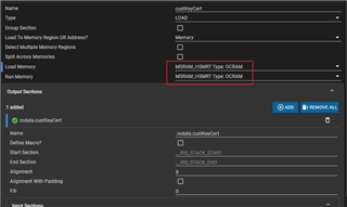

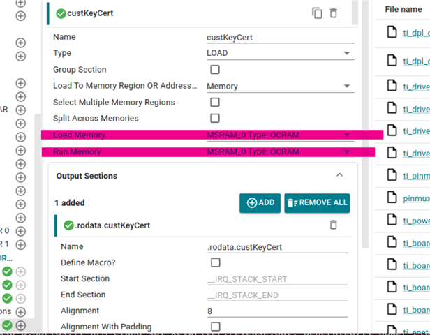

  • The certificate is placed in OCRAM and the region is config the same with yours.
    If I create section .rodata.custKeyCert and configuration as below(same with sbl_keywriter demo project). It seems hsmrt gets the key certificate successfully and the printed log is the same with  sbl_keywriter demo project.
    If I change the Load Memory of section .rodata.custKeyCert as below. It seems hsmrt couldn't get the key certificate correctly, and nothing output.
    In both configuration, I check the map file after compiling. The address of gCustKeyCert is in OCRAM, not in TCMA or TCMB.
    And I cannot find any settings in the section related to hsm access permission.
    Is there any way to find out the exact restriction for memory address of gCustKeyCert ?

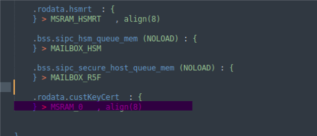

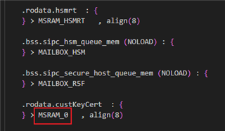

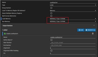

    I tried this at my end, i.e. the only change I did in the standard OTP KW is that I changed the section of .rodata.custKeyCert from MSRAM_HSMRT to MSRAM_0,
    I ran the above change in DRY_RUN MODE and was able to get the Keywriter based logs similar to the standard KW flow.
    Could you compare the standard offering with your changes and check if there are any other changes at your end?
    Note: OTP KW is a one-time process, so I would suggest you go with the standard offering.

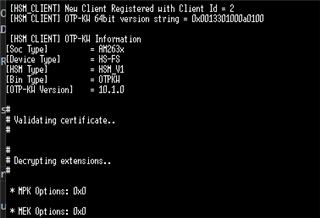

    I tried the same change in sbl_keywriter demo project and ran on AM263X Launch Board. While the result is different from yours.
    Before modify, the log is as expected.

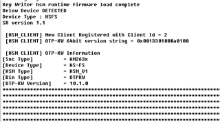

    Modify the Load Memory of section rodata.custKeyCert
    And the log is below, the same with the original issue.
    It's confusing that the result is different and is it possible for you to check the source code of keywriter hsmrt?
    Tristan

  • Hi Tristan,
    Sorry for the delay in response here.
    I was able to reproduce this issue at my end.
    Upon checking the Keywriter code on the HSM end, I found that there is a address range check being done for the certificate passed.
    #define MSRAM_CUST_CERT_ADDRESS (0x70027800U)
    #define MSRAM_CUST_CERT_MAX_SIZE (0x40000U)
    This should have been called out in the OTP KW documentation.
    I have raised this internally to address this information on the documentation, in the upcoming releases.
