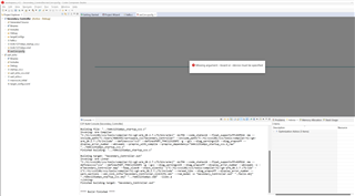

TM4C1231E6PZ: Missing arguments --board or --device error for newly created .syscfg file
Part Number: TM4C1231E6PZ
Other Parts Discussed in Thread: EK-TM4C123GXL, TM4C123GH6PM
Hi TI,
I created a simple project for TM4c1231e6pz controller just a hello world program. to this project created a new file .syscfg and i observe the attached error continuously says missing --board. To this configuration is the board needs to be connected and need to run.
how to fix this issue.
Thanks & regards,
manoj.
  • Hi Manoj,
      The .syscfg is a configuration tool that is best suited for TI MCU that uses SimpleLink SDK. There is no benefit to use .syscfg for TM4C processors as TM4C family of processors are based on TivaWare. You can still use .syscfg but its usage is more limited to only pin configuration. I will suggest you do without the .syscfg. You can remove the .syscfg if you want. As I suggested before, I will suggest you start with an existing example for EK-TM4C123GXL and modify the example accordingly for your application and TM4C1231E6PZ.  In the predefined symbols make sure you change from PART_TM4C123GH6PM to PART_TM4C1231E6PZ.

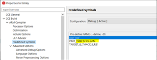

      You need to use Method 2 as Method 1 is missing configuration statements like GPIOPinConfigure(GPIO_PA2_SSI0CLK) which is used to configure GPIO PA2 as a SSI0CLK signal.
    for method1 no .syscfg is required the GPIO PIn map can be done through the driverlib. in Method-2 .syscfg is required.
    What do you mean that method 2 requires .syscfg?
    Can you just build the project with the below code? I don't have any problem building the project. What type of errors do you have if you don't have .syscfg. I mentioned several times to use an existing example as an existing example will have all the CCS project settings. For example, you can start off with a blinky project or a hello or project0 project. Try to build these simple examples. Later you can just replace the blinky.c with the below code for SSI. The TivaWare examples do not use .syscfg. This below example is from C:\ti\TivaWare_C_Series-2.2.0.295\examples\peripherals\ssi. This example configures the SSI as a master. Your above code seems to configure SSI as a slave module. But in either case, you need the GPIOPinConfigure() for proper operations so the SSI interface signals will come out on the PA5, PA4, PA3 and PA2.
