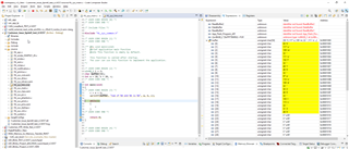

Hi!
I'm trying to implement a code that uses the sprintf() function to print data to a char. When using a formatted input (i.e.: "... %u ..."), the execution of the code stops running. If the code is paused at this idle stage, the HL_sys_intvecs.asm opens at a line that reads:
b dataEntry.
Doing a step by step debug, I've noticed that the interrupt is triggered inside the _pproc_fwp() function in the _printfi.c file, when trying to do the assignment
*tmpptr = '\0';(line 559 in my case).
My suspicion is that it could be related to the way I've configured the memory sections in the HL_sys_link.cmd file, as I'm not confident with what I did:

The code that I'm running is a simple sprintf example:
uint8_t i = 2; char buffer[50]; int a = 10, b = 20, c; c = a + b; sprintf(buffer, "Sum of %d and %d is %d", a, b, c);
