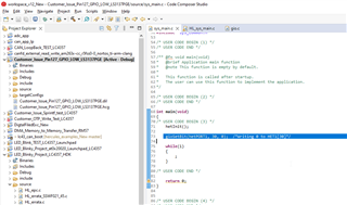

    I don't have this board to test it on my end, however i created a project with proper settings.
    Here is the project:
    Customer_Issue_Pin127_GPIO_LOW_LS3137PGE.zip
    Can you please test this project as it is on your setup?

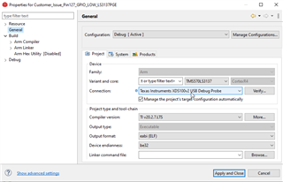

    The only thing you might need to change is:
    I created this project is for XDS100v2 debugger, verify your debugger and change this setting according to it. Keep remaining everything same and test it.
    The pin should go to Low after executing below instruction.
