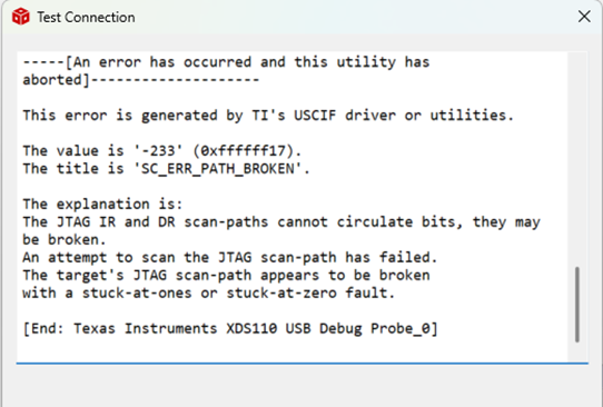

I'm working with a TI AM263Px device and using Code Composer Studio with the XDS110 USB Debug Probe. When I try to test the connection, I get the following error:
SC_ERR_PATH_BROKEN (-233)
The JTAG IR and DR scan-paths cannot circulate bits, they may be broken.
An attempt to scan the JTAG scan-path has failed.

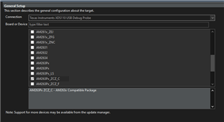

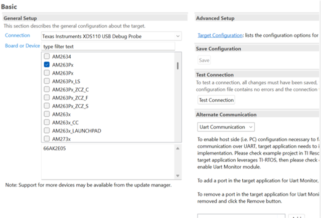

Board/Device Selected: AM263Px (in target configuration)

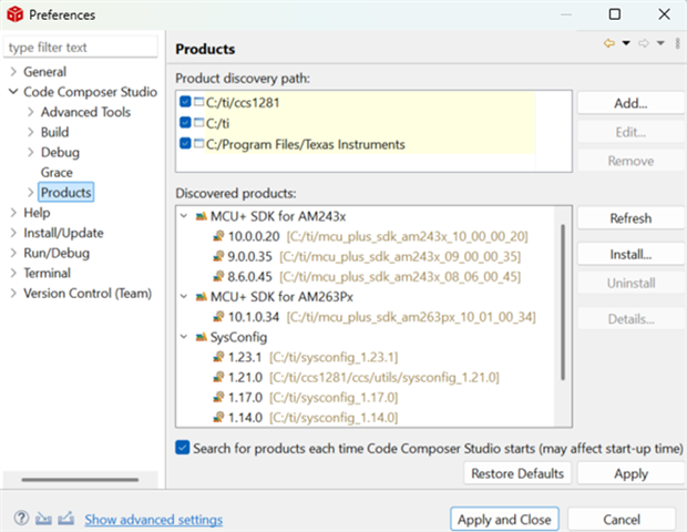

SDK Installed: MCU+ SDK for AM263Px (v10.1.0.34)
SysConfig: v1.23.1
Tested via: CCS “Test Connection” utility

SDK and board support appear correctly installed in CCS (see screenshots).
Target configuration appears correct.

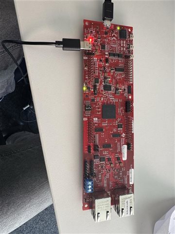

Cable and probe connection seem fine physically.
Board is powered on.

Target configuration with AM263Px selected.
Installed SDKs and SysConfig in CCS.
Error message from test connection window.
