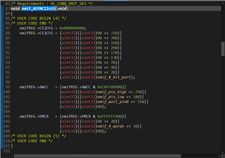

I am currently facing an issue with EMIF during write operations. My objective is to achieve the maximum speed of EMIF, and for that, I have configured the lowest possible timings in the Asynchronous Configuration Register (CE2CFG). Specifically, I have set the write and read setup, strobe, and hold times to 0.

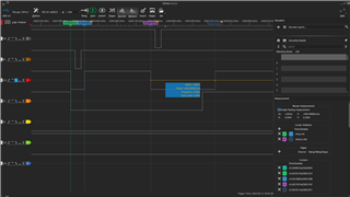

Based on this configuration, the expected time to write one byte of data to external asynchronous memory should be approximately 40 ns for both read and write operations. However, in practice, I am observing that the write operation takes around 220 ns, which is significantly higher than the configured value. On the other hand, the read timing is close to the expected value at approximately 44 ns.
I have attached the logic analyzer capture and the EMIF configuration screenshot for your reference.
Could you please help me identify the cause of this discrepancy and suggest possible solutions to achieve the desired write performance?

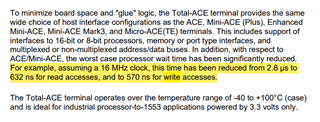

    If this is true, then according to this device the max supported clock is 20Mhz only:
    And here they are mentioning that the write access can be upto 570ns:
    So, i am suspecting that slave device is too slow not the master of EMIF. I think this is impacting the throughput.

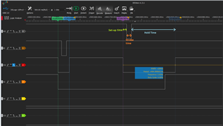

    I did some analysis on your generated waveforms and found this:
    On your generated waveforms, the setup and strobe periods are very less, and they are equal to the read operation timings. And only the hold period is more as compared with read operation. For more details about the definitions of these timings refer below section in TRM:

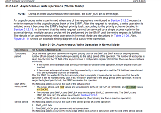

    According to TRM this hold period can only be varied by two parameters:
    1. W_HOLD, in write cycle this W_HOLD value decides the period of the hold time:
    Verify the value that you configured in this field.

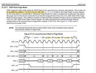

    2. In NAND flash mode if we enable the page mode, then depends on the pages it will extend the hold period.
    I think this should not be applicable for your case, however, check it once.
