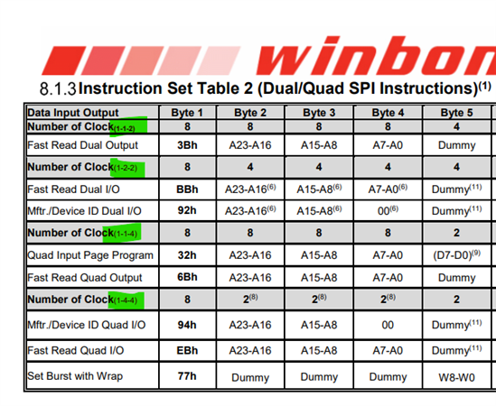

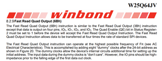

Hi Team,
In the following document for supported flash parts for AM243x, it says that W25Q Winbond flash is supported.
Could you tell me what operations were tested for this flash? My customer wants to boot in QSPI mode.
