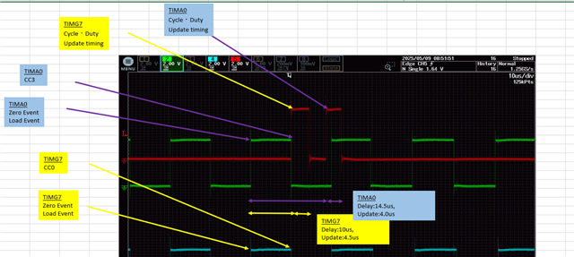

  • Hi Sal,
    There has been progress in customer testing.
    I will send you the sample code via private message.
    We investigated the causes of the delay by reflecting the settings changed by our company based on the sample source code.
    Sample: timx_timer_mode_pwm_edge_sleep_shadow_LP_MSPM0G3507_nortos_ticlang
    ・Added PA3 as GPIO.
    ・Measured time by turning port output ON/OFF.
    ・Reflected the differences between the sample and customer project on SysConfig
    and applied them to the sample, but there was no delay in the sample.
    • In the customer project, delays and variations in delay times occurred.
    • Next, we focused on the differences in interrupt handling between the sample and the customer project,
    and added SysTick to the sample, but the results remained unchanged.
    • Since ADC was being processed by interrupt, we stopped ADC, but the results remained unchanged.
    • No interrupts were used except for SysTick, ADC, and Timer.
    ・As a precaution, we checked the PWM zero event occurrence flag via polling, and found that the zero event occurrence was delayed by approximately 1.5us.
    ・In the sample project, when interrupts were used, the interrupt handler processing started in less than 1us, so we would like to use interrupts if possible.
    [Question]
    Please let us know if there are any settings that cause a delay in the time between the zero event occurring and the interrupt processing starting. We will change those settings.

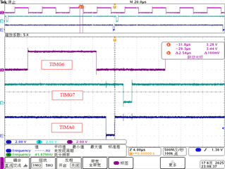

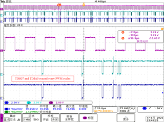

  • Hi Ito,
    Sorry for late response. I have checked your message and done some test for this scenario. And I do see the deviation on the phase between TIMA0 and TIMG7 when dynamically update the period and duty cycle.
    And I check this only related to period modification behavior, duty doesn't impact the phase.
    The reason I am thinking that load behavor by the shadow LOAD register might contributes some timing deviation, so the phase shift occurs. And software trigger only sync the timer instance at first, after they started, it will not generate the cross trigger signal unless user add it in the application code and periodically call the API.
      [After modify several times of the period, phase shift shows up]
    My suggestion is use TIMG7 to trigger TIMA0 directly and set the EVEVNT trigger mode as zero, so that it will be synced every PWM cycles.
    One thing is that, it requires to set LOAD as interrupt resource, as user has set shadow CC and shadow Load functions, which triggered by ZERO EVENT, there might have register contention, and lost some period update [I have obeserved this issues if set ZERO as interrupt source].
    -> Haven't dig it deeply, just some rough idea.
    Attached the test project as your reference. I find a bug that the sysconfig tool generated code has issues, so I manually fix it in the exmaple project by exclude the generated source file.
    CrossTrigger_Test_G3507.ZIP
    Please let me know if you have further questions, thanks.
