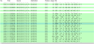

  • Hi Sahar,
    Comparing the wireshark logs for no issue and with issue, and I see that 0x0442 Register value is 1 (PD Watchdog expired) whereas for the working case, it's 0:
    0x0443 (PDI Watchdog Expiry count) is incremented in both the cases. Apart from this, I don't see any other issues with the ESC Registers.
    Additionally, we want to understand from the PLC's point of view on which type of frame the PLC is sending out when Reset All is done and how the ESC is taking care of that frame/datagram. So for that, could you share the wireshark logs during Step 4 to Step 6?
    Aaron

  • Hi Aaron
    Attached are wireshark logs for when "Reset All" causes fall to init and where it doesn't.
    In addition, i attached the PHY registers values of the two drives in chain, one in a "good" condition and the other in a "bad" condition.
    Sahar
    wireshark_rec.zipPHY_Compare.xlsx

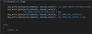

  • Hi Sahar,
    0x0141 is updated by the EEPROM:
    Snapshot taken from bsp_eeprom_load_esc_registers() API in tiescbsp.c:
    The contents of eeprom_cache[1] is written to 0x0141 ESC Register.
