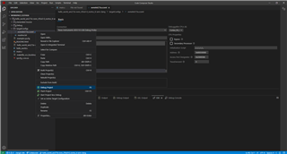

  • Hi Konstantinos,
    The recommended CCS version for AM273x MCU+ SDK 09.02.00.52 is 12.7.0, but the CCS 20.1.0 should work too.
    Here is how you import, build and debug an existing CCS project:
    1. File --> Import Projects --> select the CCS project to import (e.g. C:\ti\mcu_plus_sdk_am273x_09_02_00_52\examples\hello_world\am273x-evm\r5fss0-0_nortos)
    2. Build the CCS project
    3. Under targetconfigs --> right click on evmAM273x.ccxml --> select "Debug Project"
    Ming
