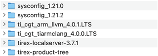

The issue is the path ti-cgt-armllvm_4.0.1.LTS/bin/tiarmclang. There are dashes in the ti-cgt-armllvm_4.0.1.LTS vs the path on disk uses underscores and an additional underscore between arm and llvm. This is in the imports.mak file
Manually modifying the imports.mak file and issuing build. The following next error is presented
