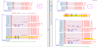

Our application flashes USER_LED1 on the E2 board but it does not on the A board. The cause is because it's been moved from EPW11_B to EPWM7_B:
In turn, that means pin 64 on the HSEC has become NC on the Rev A board. However, the user guide still lists pin 64 as follows:
I would like to know what other E2 / A HSEC differences there are that might impact our application.
Please provide the list of differences or provide a correct HSEC table for Rev A.
