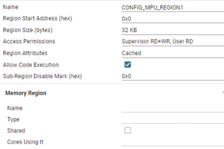

    Can you please check the MPU settings in the project for this address? Is this address 0x40 accessible by the core?
    Tushar
  • Hi Tushar,
    As far as I can see, the settings are the same as the ones for TCMA in the example projects:
    I can access the location in memory browser (read/write).
    Best regards
    Johannes
