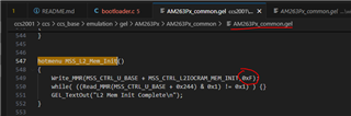

I've had quite a few issues with accessing data placed in bank4 and bank5 of OCRAM on AM263P launchpad recently, mainly when running through the CCS debugger.
I think one of the reasons is that the startup .gel file for AM263P setting up OCRAM (MSS_L2_Mem_Init) was only initialising the 1st 4 banks rather than all 6, by only writing 0xF (0b1111) to MSS_CTRL_L2IOCRAM_MEM_INIT rather than 0x3F (0b111111)

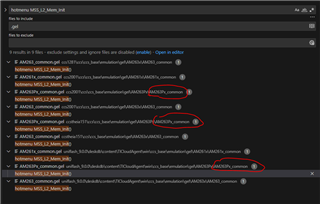

I have various programmes installed (CCS, CCS theia, Uniflash) and this seems to be the case for the MSS_L2_Mem_Init definition for all three cases:
For ccs2001:
For ccs theia:
For Uniflash:

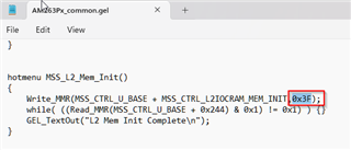

So the fix there seems to be updating the register to 0x3F:
As the AM263P (with 6 banks of OCRAM) is based on the AM263 which had 4 banks of OCRAM it's obvious where this issue came from.

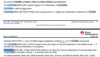

Similarly, in revision of the AM263P technical manual, there seem to be a few remaining references to 4 banks of OCRAM vs 6, for example page 217

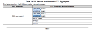

Possibly also on page 1492:
Could someone check this?

    The issue on the value of mem_init field in AM263Px_common.gel is fixed in the internal versions and will be part of next p2 update on CCS 12.8.1 version and CCS 20.2.
    I have notified the Documentation team regarding missing mentions of bank 4,5 in AM263P TRM. This also will be fixed in the next TRM release.
