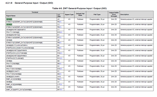

İ can control push button status. Push button is GIO port A pin 7. But when i control port A pin 7, i dont appear push button values. I can see it on GIO portA pin 6.
It says 7 in the document and on the board.
What is the reason for this ? Is 0 ignored when preparing document ?
