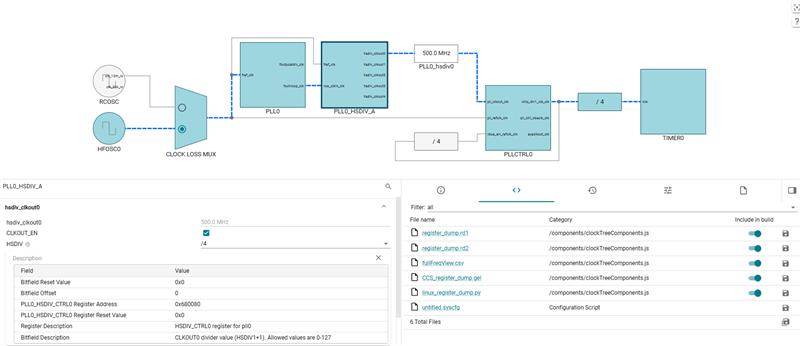

    For example, if I want to change the Timer0 clock, I need to modify the PLL_HSDIV_A output to generate different frequency.
    This can be done by modifying HSDIV value in PLL0_HSDIV_CTRL0 Register at address 0x680080.
    Please refer the below image.
    Be cautious while you change any PLL, as this are connected to various other IPs and will impact the overall system performance.
    Hope the above information helps.

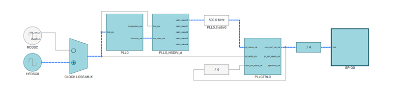

    I will generate clock on GPIO channels.
    My understanding is that PLL is internal resource that provide reference clock to Timer by physical route.
    But as fresher, I am not sure if PLL can be routed to any GPIO channel to give specified clocks (e.g. 100KHz, 1MHz).
    Can you please suggest good approach to create clock on GPIO channel?
    If we have to utilize Timer, do we need to use interrupt?

  • Hi Hao,
    Yes, the above understanding is correct.
    The GPIO module is connected to the PLL0_HSDIV_A and a divider which feeds 125 MHz frequency to the GPIO module.
    Please refer below image.
