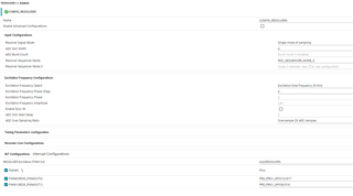

As HW ive a custom board.
Here is my config for the resolver:

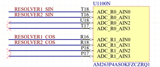

Here are my HW connections:
A resolver is only connected to RESOLVER1.
1) As Excitation PWM Out ive selected 2 pins. regarding this post:https://e2e.ti.com/support/microcontrollers/arm-based-microcontrollers-group/arm-based-microcontrollers/f/arm-based-microcontrollers-forum/1345059/am263p4-does-the-resolver-support-output-differential-pwm
its the same output just at 2 pins. My problem is, that i can see the excitation PWM at PWM0, but at PWM1 there is just 0V (checked HW, there is no short zo GND at this line). Any ideas, why i don't see the excitation PWM there?

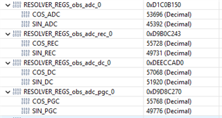

2) Nevertheless if i check the resolver 2 registers i see the following values:
which change if i turn the resolver which is only connected to resolver 1.
If i measure the voltage at pcb with oscilloscope  at RESOLVER2 SIN or RESOLVER2 COS its flat 1.65V (reference voltage for input amplifier).
So i would expect stable values for the angle and velocity.
Do you have any idea why the values change?
Can i check the measured raw ADC values in any register? I only found the calculated arctan and track2 values i posted above.

    meanwhile i looked deeper into my problem and found out some things regarding point 2:
    I found some registers with ADC values:
    is there anywhere more information to this registers as i find in their description?
    ADC is 12bit, these registers are 16bit. How can I claculate back my raw valtage at the input pin?
    Moreover i tried to check if my pinning is correct.
    I coudn't find any information about single ended pinning in TRM. But i found that in an SDK example:
    Can you confirm, that this is the correct pinning if i want to use RCD Sequencer mode 3?
    If so, is there any way how i could fix this Hardware issue in Software?

    Assuming you are using single ended signals, these connections do not match any of the configurations given in Section 7.5.3.2.2.1.1 Sequencer and RDC Modes of Operation of AM263Px Sitara Microcontrollers Technical Reference Manual (Rev. C). You would have to modify these connections. Please refer to the Figure 7-165 to Figure 7-170 for all the 6 configurations possible.
    So, with the current hardware configuration/connections, you will be able to use Mode 0(as per Section 7.5.3.2.2.1.1.1 Mode 0 of TRM), where in only the External Resolver 1 is correctly connected to ADC_RO_AIN0 and ADC_R1_AIN0 pins.

    Since you have mentioned in second answer that you are using Sequencer mode 3, the above connections might be causing both the RDC values to change. So please correct the connections as mentioned earlier.

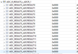

    These can be read using the ADC Result registers of ADC_R. Pleas refers to ADC_R_RESULTS Registers at 0x502C6000 for ADC_R and 0x502C8000 for ADC_R1.

    Please refer to Section 3.12.1 RESOLVER Summaries of AM263Px Sitara Microcontrollers Register Addendum (Rev. A) starting from address 0x502CB0EC and 0x502CB2BC.
    Yes, the pinning mentioned in the table is correct and matches that of Figure 7-168. Mode -3 of AM263Px Sitara Microcontrollers Technical Reference Manual (Rev. C). The Figure 7-168 shows the differential connections, single ended connections can be referred from the same(positive signals only)
    I don't think it is possible to fix this issue in software for using the Resolver to Digital Converter Functionality.
    These registers are just showing zeros:
    while the resolver registers show values:

    Can you please just try configuring the Resolver ADCs and just try reading the values, just to ensure the signal is actually reaching the ADCs?
    Also, if possible, can you probe on the board and actually check if there is some signal reaching these Resolver ADCs?

    Resolver 1 is connected propperly the results comming out of the resolver interface (angle and velocity) looks pretty good. So signals are reaching the Resolver interface.
