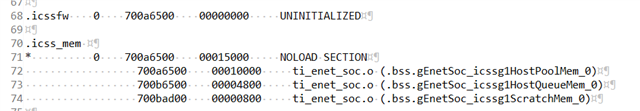

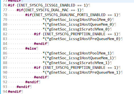

  • I have identified the cause of the issue I raised.
    The .icss_mem section of the linker.cmd provided in the example is as follows.
    When icssg1 is set to dual mac mode in sysconfig and port1 and port2 are added, only the following memory is linked in the map file.
    - gEnetSoc_icssg1HostPoolMem_0
    - gEnetSoc_icssg1HostQueuelMem_0
    - gEnetSoc_icssg1ScratchMem_0
    However, since Port1 and Port2 should use separate memory, the linking should actually be as follows:
    - gEnetSoc_icssg1HostPoolMem_1
    - gEnetSoc_icssg1HostQueuelMem_1
    - gEnetSoc_icssg1ScratchMem_1
    After modifying Linker.cmd to link all the above areas, I confirmed that the issue was completely resolved.
    Please update this section accordingly.
