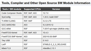

    • As mentioned in the Release Notes, we have verified only using CCS 12.7 for Industrial Communications SDK 09.02 or MCU+ SDK 09.02.
    • CCS 20.0.1 (Theia) is not currently supported for our current SDKs. You will have to use CCS 12.7 for your development for SDK version 09.02.
