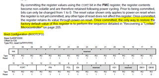

    Your understanding is correct. You can force the device into bootloader mode by configuring the BOOTCFG register and specify a GPIO pin as an input to force the device into the bootloader mode.
    This register is not written directly, but instead uses the FMD register as explained in “Non-Volatile
    Register Programming-- Flash Memory Resident Registers” on page 613. When this register is
    committed, the new value cannot be read back until after the power cycle. This register provides
    configuration of a GPIO pin to enable the ROM Boot Loader as well as a write-once mechanism to
    disable external debugger access to the device. At reset, the user has the opportunity to direct the
    core to execute the ROM Boot Loader or the application in Flash memory by using any GPIO signal
    from Ports A through H as configured by the bits in this register. At reset, the following sequence is
    performed:
    1. The BOOTCFG register is read. If the EN bit is clear, the ROM Boot Loader is executed.
    2. In the ROM Boot Loader, the status of the specified GPIO pin is compared with the specified
    polarity. If the status matches the specified polarity, the ROM is mapped to address 0x0000.0000
    and execution continues out of the ROM Boot Loader.
    3. If the EN bit is set or the status doesn't match the specified polarity, the data at address
    0x0000.0004 is read, and if the data at this address is 0xFFFF.FFFF, the ROM is mapped to
    address 0x0000.0000 and execution continues out of the ROM Boot Loader.
    4. If there is data at address 0x0000.0004 that is not 0xFFFF.FFFF, the stack pointer (SP) is loaded
    from Flash memory at address 0x0000.0000 and the program counter (PC) is loaded from
    address 0x0000.0004. The user application begins executing.
  • Ok. What is the default for the BOOTCFG register? If I did not program the chip, what would be the default GPIO pin and polarity?
      The default value of BOOTCFG register on a virgin device will be 0xFFFFFFFE. If you look at the bit 8 (EN), it is a 1. This means that GPIO is disabled from forcing the device into ROM bootloader at reset. You can program the PORT, PIN and POL fields to specify which Port pin and polarity to enter ROM bootloader execution. If you only clear the EN bit, then by default a HIGH level on Port H7 will be recognized to enter ROM bootloader.

    Can you give me an example of a blinking light program with a modified BOOTCFG that would be the recommended practice for loading a first program or any program such that one can always invoke the ROM bootloader by bringing a GPIO pin high?
  • 1. Start with a virgin device or you can first erase the entire flash.
    2. You need to use the FMA, FMD and FMC to program the BOOTCFG register. Note this is a one time program. Once programmed, the only method to change its value again is to do a "Unlock" operation and restore the device to its factory setting. Use the below code as an example to use Pin E6 on HIGH to execute ROM bootloader.
    // FMA should have this value to program BOOTCFG
    HWREG(0x400FD000) = 0x75100000;
    // Data to be flashed in BOOTCFG, must be stored in FMD
    HWREG(0x400FD004) = 0xFFFF9AFE; //FMD to enable Port E6 on HIGH for ROM bootloader execution
    // FMC should have writekey and commit bit
    HWREG(0x400FD008) = 0xA4420000 | 0x9; // FMC
    // Wait until commit is complete
    while (HWREG(0x400FD008) & 0x9);
    3. With the Pin E6 LOW, load your blinky code using LM Flash Programmer in UART mode. Note the flash at this moment is still empty. It does not matter if GPIO pin is asserted or not because the stack pointer and reset vector are all F's.
    4. You should see the blinky program loaded
    5. With the Pin E6 still LOW, load another program like the hello.c using LM Flash Programmer in UART mode. It will not load because a valid program image is already in the flash and the Pin E6 is LOW.
    7. Change the input E6 to HIGH.
    8. Load the hello program and the bootloader is forced to load the hello program and overwrite the blinky on the flash memory.

  • Charles,
    So what I would like to run on a virgin device will be the following and my expectation is that I will use GPIO pin PD1 and ground it to enable the bootloader. How does this look?
    #include <stdint.h>
    #include "inc/hw_memmap.h"
    #include "inc/hw_types.h"
    #define FLASH_FMA  0x400FD000
    #define FLASH_FMD  0x400FD004
    #define FLASH_FMC  0x400FD008
    int main(void)
        // 1. FMA should have this value to program BOOTCFG
        HWREG(FLASH_FMA) = 0x75100000;
        // 2. BOOTCFG value: PD1 active LOW = 0xFFFF65FF
        HWREG(FLASH_FMD) = 0xFFFF65FF; //FMD to enable Port D1 on LOW for ROM bootloader execution
        HWREG(FLASH_FMC) = 0xA4420000 | 0x9;
        while (HWREG(FLASH_FMC) & 0x9);
  • You didn't clear bit 8 which is to enable GPIO for ROM bootloader. Should be 0xFFFF64FE.
  • Thanks for catching that. Here is the what I am going to go with. How does that look?
    #include <stdint.h>
    int main(void)
        HWREG(FLASH_FMD) = 0xFFFF64FE; //FMD to enable Port D1 on LOW for ROM bootloader execution
  • Yes, that should do it.
  • Got it working! Thanks for the support!
