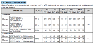

Good day TI team,
Based on data sheet section "7.5.2 STOP/STANDBY Modes",
Understanding is: To go to standby mode, operating frequency needs to be 32MHz.
Please correct me, if mismatch in understanding.

Hi Selvam,
I think you meant 32 kHz. Whenever the device goes into STOP2, STBY0, or SBTY1, the device will only have the 32 KHz clock to source other peripherals out since the 32MHz clock will be disabled.
