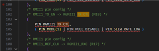

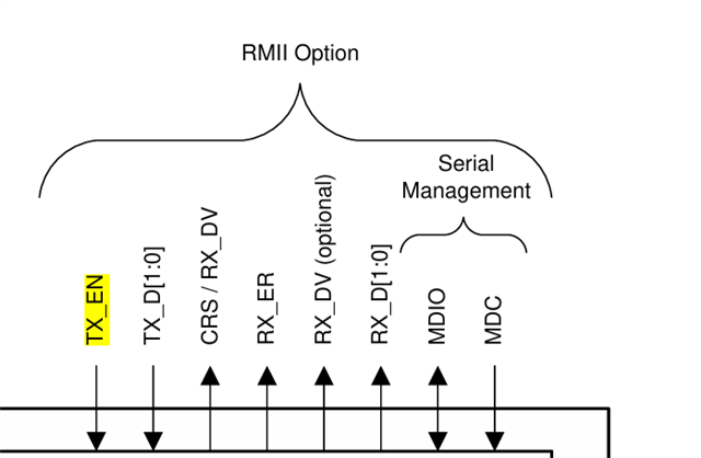

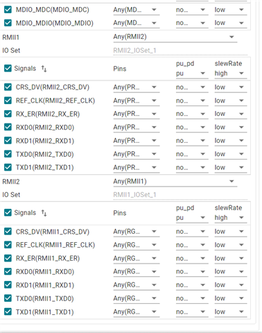

Tx control pin also required to configure RMII mode in AM2634 but while generating code by sysconfig TX_CTL not configured,
please look into this and please suggest the alternative solution as of now
Required pins for RMII interface
