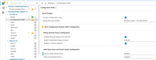

Hello, How to set Flash read protection so that it cannot be read via SWD interface, like STM32, by setting specific option bytes.
Part Number: MSPM0G3507
You can set the configuration in Sysconfig-> Configuration NVM->BCR configuration to select the protection level you want to use.
You can refer to the TRM chapter 1.4.2.1 Serial Wire Debug Related Policies for more details about different protection level. https://www.ti.com/lit/ug/slau846b/slau846b.pdf
