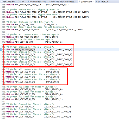

1-In sysconfig i can't see the ADC configurations for current sensing in i can see only ADC0_7, ADC1_6 and ADC1_3 are the only channels configured.

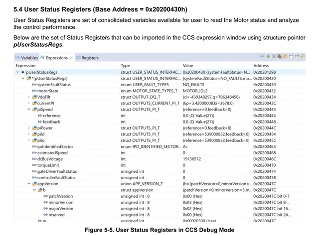

3-Can i debug in transition between states, for e.g i can't debug where the motorState variable is changing in sensorless version of the code is this provided as some library not open code?

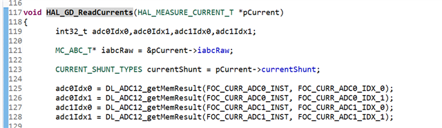

    yes, the adc channel init is done inside application code, due to there will have some channel switch depends on the configuration customer select.
    See below code inside the SDK for your reference:
    Where the algorithm to read back ADC result:
    Where the algorithm configure the ADC channel:
    Where the macro definition for ADC channel:
    You can find it in the below register:
