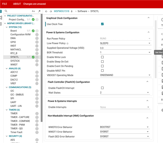

MSPM0G1519: Configuring BOR interrupts using sysconfig
Part Number: MSPM0G1519
Dear Experts,
Can't I directly configure BOR interrupts in sysconfig? I cannot find the BOR interrupt option in the NMI configuration in sysconfig. Does it mean that I can only configure it myself in the program?Thank you
    I do not think it requires to configure the BOR interrupt in sysconfig since it is an NMI interrupt source.
    After you have set BOR threshold level, then the interrupt should be enabled. No other setting is needed. And you can check in the NMI interrupt routine about the results.
