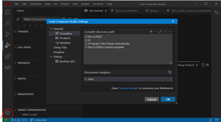

      For TM4C, please use the TI Arm Compiler and not the Clang compiler. There is some incompatibility between TivaWare SDK and Clang compiler. CCS20 by default only has the Clang compiler installed. You will need to manually install TI Arm Compiler which you can download from https://www.ti.com/tool/ARM-CGT.
    Once you download and install, make sure CCS20 will automatically detect the path to the installation location by going to the setting. See below image at the lower left setting icon and update the discovery path. You can also watch this CCS20 video training. https://www.youtube.com/watch?v=1jkpPGcbxxA. Having said that, if you are used to the Eclipse-based CCS12 and prior versions and no strong desire to incur some learning curve on the Theia-based CCS20 then I will suggest you stay with the CCS12 version. For myself, I'm still using CCS12 for my daily work. By all means, you can use CCS20 if you want. It is just that you need to make CCS20 detect the TI Arm compiler path.
