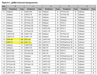

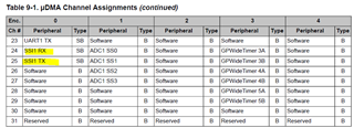

I'm using the TM4C1231E6PZ MCU and i want to know if the SSIO supports the DMA rx feature in this series?
Please confirm if this works or not? if yes which example i can take?
Thanks & Regards,
Manoj.
      TM4C1231E6PZ supports DMA for SSI module. You can find uDMA example at C:\ti\TivaWare_C_Series-2.2.0.295\examples\boards\ek-tm4c123gxl\udma_demo. This example demonstrates using uDMA to transfer data between memories and also between UART and memory. You should be able to reference the example and modify for SSI module base on the channel mapping for SSI as shown in the datasheet for uDMA usage.
