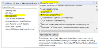

Is there any possibility to debug the application code via CCS with XDS110 without any effect on/ without erasing Bootloader / any specific memory location. If yes please guide the proper steps.
Because the problem we are facing is - when bootloader is flashed via Uniflash and then XDS110 debugger is connected for application debug , where we have to get the bootloader version saved in specific memory location is getting erased when connected.
