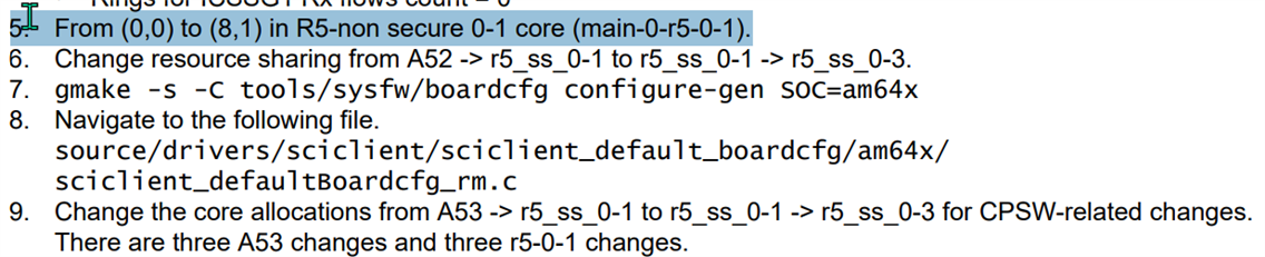

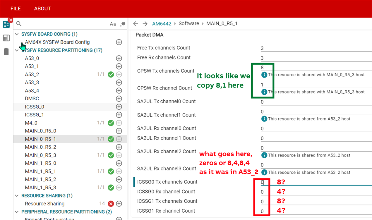

    As you can see, step 5 is a sentence fragment. From what I can make of it this is suggesting that I allocate the CPSW-related packet DMA for TX/RX channel to core MAIN_0_R5_1...is this correct?
    • Or should I reallocate all CPSW/ICSSG0/ICSSG1 packet DMA for TX/RX channels as well as packet DMA rings for same?
    • For example, should I make packet DMA for ICSSG0 Tx channels set to 8, as it was in the A53_2 settings?

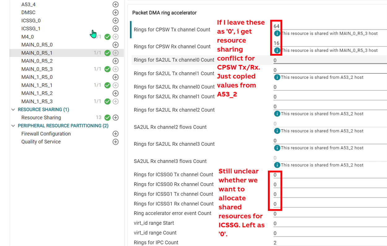

    • What about the packet DMA ring accelerators?

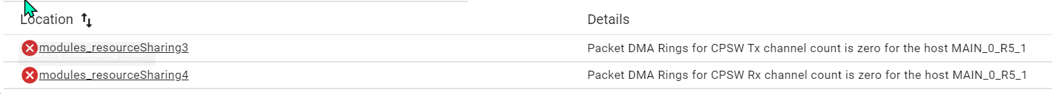

    • Below is the resource sharing conflict if I leave Packet DMA ring accelerators for CPSW Tx/Rx channel count as '0'.
    In step 6, it is not made clear if all remaining/existing resource sharing instances of A53_2->MAIN_0_R5_1 should be changed to MAIN_0_R5_1->MAIN_0_R5_3
