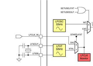

The MSPM0G1X0X has two input ports (LFXIN, LFCLK_IN) for external low-frequency clocks.
I would like to input and use a digital signal from an oscillator, but due to the surrounding wiring I would like to use the LFXIN pin instead of LFCLK_IN.
The LFXOUT pin will be designed as an open port.
Are there any inconveniences that could arise in this case?
    What do you mean by "input and use a digital signal from an oscillator"? If you are plan to use a digital signal input, then you must use LFCLK_IN pin as its input pin. The LFXIN could not be used for digital signal input.

    As you wrote, I am trying to use the LFXIN pin as a digital signal input.
    I checked 7.9.4 Low Frequency Crystal/Clock in the datasheet and the user manual, but could not find any problems with the specifications.
    The frequency range and duty ratio of LFCLK_IN are stricter.
    What is the problem?
    Is it the voltage level or the status of the LFXOUT pin?
    Kamitani
    It is just that the LFXIN is not designed with the ability to accept digital input signal.
