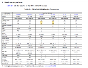

    We are currently utilizing the TMS570LS0914 microcontroller in one of our existing products. As part of the development of the next-generation version of this product, we are evaluating various peripherals and functionalities. For this purpose, we are using the development board for the TMS570LS12x/11x series.
    We would like to confirm whether the peripheral functionalities tested and validated on the TMS570LS12x/11x development board can be directly applied to our product based on the TMS570LS0914 microcontroller, using the same code without modification.
    Kindly confirm.
  • Prajakta,
    Apart from flash and RAM sizes i don't see any other difference between these two parts.
    And also, endianness of these devices also same i.e. Big Endian.
    So, you can directly use the code between these boards interchangeably without any modifications.
