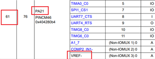

i'm trying to setup the project for getting VREF into my circuitry but failing to do so. no voltage on PA23 (VREF)

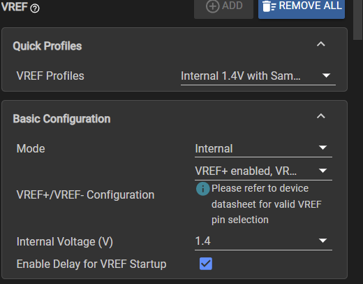

the configuration is
the configurator tool is still failing?
  • Thank you for your feedback!
    I check the latest syscfg, it has already fix this issue, syscfg 1.23.1
    You can use these Vref+/- pin without influence.
    Because Vref pin is analog function, these external Vref configuration won't create any GPIO init code in ti_msp_dl_config.c
    This means whether this issue is fix or not, your app code is same.
