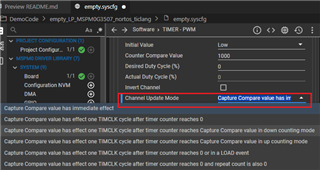

    I saw some duty very large during duty changing, please try to enable TimerA's shadow CC function in syscfg.
    You can got related description in TRM of this shadow CC function:
    https://www.ti.com/lit/ug/slau846b/slau846b.pdf
    27.2.4.2 Shadow Compare (TIMG4-7, TIMG12-13, TIMA only)

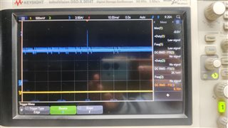

    I have enabled shadow in sysconfig.
    DL_TimerA_enableShadowFeatures(PWM_0_INST);   -- Still the current waveform is same. Is there any setting missed or  may be i have not configured shadow properly.

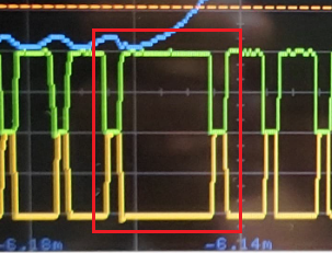

  • If shadow CC is works, you won't see this large duty here:
    Please try to test more option in syscfg here:

  • Hi Helic Chi,
    Thanks for the information.
    Shadow feature helped. However the current waveform have ripple to nature of hysteretic control.
    Do you have any suggestions to improve current waveform ?
