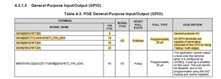

    I think the issue is with the names given in the HALCoGen, here the names were wrong:
    Actually, there were GIOA[0], GIOA[1] and GIOA[3] etc. right?
    So, the correct order of the names should be this:
    So, if you want to do any configurations related to GIOA[2] then use the first box instead of third box, this will give you the correct code generation.

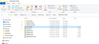

    If you want to rectify it on HALCoGen itself, you can do the modifications in below xml file of the HALCoGen:
    Open below xml file using notepad:

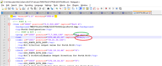

    In this file, here you can see the mistake that Bit 2 is calling as GIOA[0] right?
    Change it to GIOA[2] like below:
    And also do the changes for other pins, once you made the changes then please close and open the HALCoGen:
    Now you can see the correct names:
