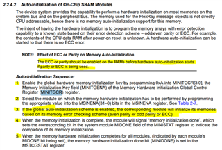

In my application DMA and DMA parity check is using.

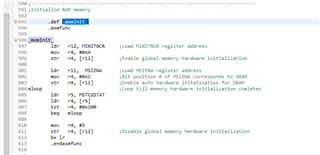

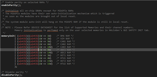

I do the MINITGCR = 0xA to enable memory hardware initialization and MSINENA = 1 to initialize DMA RAM.
When I start the code with DMA parity enable by setting DMAPCR and DMA receiving data, there is continuous ESM group 1 Channel 3 DMA parity error.
