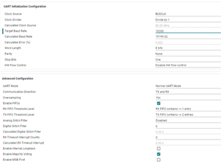

I have collected some more information. First, I'd like to share some details about how we are handling received data, as it might be peculiar.

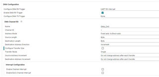

We are running this data bus at 10MBaud and using DMA to collect the received data in a buffer. We do not know how long each line on the data bus will be, so we are running DMA one byte at a time, and have the UART FIFO enabled:
Transfer size is configured at runtime to be the size of the receive buffer, so that we can let DMA handle data until our end of line characters are received. We send/receive two EOL characters at the end of every line.
Baud rate is also set at runtime.
To detect EOL, I am using the UART RXINT to trigger searching the buffer for the first EOL. It would certainly be better to perform this search after the DMA completes, but I did not see a good way to get an interrupt after the DMA is done with each individual character yet keep the DMA active in case the interrupt is handled late. This isn't a problem though, as with two EOLs, we can just search for the first, and missing/discarding the second EOL isn't a problem.

I noticed the reference manual details two ways for RXINT to be cleared. The first, by reading IIDX as our interrupt handler does:
But this can also clear the interrupt, which the DMA will be doing often:
However, there is some timing I can't yet explain. I'd expect the DMA to often complete before our interrupt handler is called, causing the interrupt handler to see IIDX set to 0 most of the time, if not always. But I only observe IIDX set to zero in the interrupt handler at the end of a received line, and only at the end of every couple received lines.
When I modify the sender to wait roughly 2ms between sending each byte, IIDX is never observed as 0, even if a delay is added between the interrupt handler call and checking IIDX. Perhaps it is somehow related to interaction between the DMA and the FIFIO, when the FIFO contains more than one byte?
