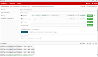

Step#1 : Build SDK empty example "empty_am263px-cc_system_nortos".
Step#2 : In Uniflash, configure "empty_system.appimage" or "empty_system.mcelf" as Application image.
Step#3 : The customer tried to use "sbl_ospi_multicore_elf_am263px-cc_r5fss0-0_nortos_ti-arm-clang" as SBL, but linker error was generated.
So they used "sbl_ospi_am263px-cc_r5fss0-0_nortos_ti-arm-clang" instead.

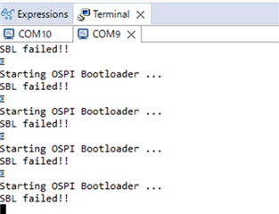

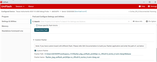

Step#4 : Flash OSPI memory
Step#5 : Change boot mode as OSPI boot and power cycle the board. Below is terminal output.
