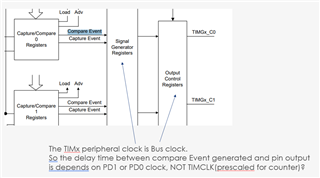

My customer is developing with MSPM0G3507.
And they have question about TIMx event delay time.
Question1
If the PWM output using "Output control Registers", The delay time of between Compare Event and Pin Output(Hi ->Low) depends on which (TIMCLK or peripheral bus clock) clock?
In their test, the delay time is related TIMCLK. (if TIMCLK use more fast clock (change prescale value), the delay time was more less.)

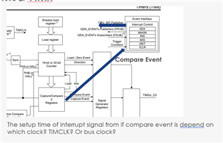

Question2
If GPIO output use compare interrupt, The delay time between Compare event and Pin output depends on periperal bus(PD0 or PD1) and CPUCLK?
I believe this delay time is const, even if change TIMCLK prescaler. Is this correct?
GR
  • If the PWM output using "Output control Registers", The delay time of between Compare Event and Pin Output(Hi ->Low) depends on which (TIMCLK or peripheral bus clock) clock?
    TIMCLK.
    Almost correct. Power domain(PD0 and PD1) will influence the event trigger time.
    CPUCLK influence the interrupt entering time.
    It's easy to test this by comparing PWM edge and Debug GPIO set in interrupt.
    It's about 30~50  CPUCLK from my previous test result.
