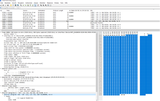

  • Hi Aaron,
    Every test of the CTT with SafeOP & OP state needed fails, because the Logical ReadWrite Datagram for the PDOs isn't working.
    The EtherCAT frame (with the LRW datagramm) sent back to the EtherCAT Master is damaged.
    conformanceTest_INIT_SAFEOP_FAIL_OP.pcapng
    This is a Wireshark file showing the problem.
    Stefan

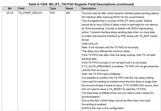

  • On an additional note, can you make sure that the TX_START_DELAY is increased to 0x98 in the application? The access to multiple FMMU mapped areas using LRD/LWR commands from a single SubDevice needs increased latency and with the default value (0x48), the tests will fail. These can be verified by checking the value in MII_RT_TXCFG0 (0x300B2010) and MII_RT_TXCFG1 (0x300B2014):

  • Hi Aaron,
    I noticed today that the define ENABLE_MULTIPLE_SM_ACCESS_IN_SINGLE_DATAGRAM in tiescbsp.h is set to 0 per default. Enabling it changed the value of TX_START_DELAY to 0x98. There are also the defines TIESC_PROCESS_PATH_TX_DELAY_... and  TIESC_AUTOFORWARD_PATH_TX_DELAY_..., which we did also change to 0x98 for testing. However, we still do not reach OP with the Conformance Test (it still works with TwinCAT). The LRW frame seems to be cut. At the end, where the working counter should be, you see the CRC32 value of the frame. It is there, because the frame was cut.
    Do you have an idea why this happens?
    • This is fine as the EtherCAt firmware dynamically configures the delay to 0x98 based on the number of FMMU entries and the access permission of these entries.
    • Thank you for the confirmation. The WKC of 31328 shows that there's some configuration mismatch in the processing path, which is forwarding incorrect values. We will check further on this.
    Aaron
  • Hi Aron,
    the abnormal WKC of 31328 is, as we think a missinterpretation of  Wireshark.
    Some data in the EtherCAT frame is missing. Wireshark is reading the first 2 Byte of the Ethernet CRC32(at the end of the Frame) as WorkingCounter data.
    Can you confirm this?
    Stefan
  • Yes correct. There seems to be a mismatch in the datagram transmission after the PDO data has been processed, resulting in malformed packets. We are checking on this.
