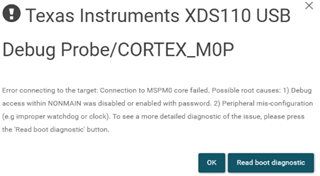

  • Tried to load customer_secure_sample_image and got this error:
    CORTEX_M0P: Unable to determine target status after 20 attempts
    CORTEX_M0P: Failed to remove the debug state from the target before disconnecting.  There may still be breakpoint op-codes embedded in program memory.  It is recommended that you reset the emulator before you connect and reload your program before you continue debugging
    Then tried to load the program which was loaded and run successfully before and got this error:
    CORTEX_M0P: Error connecting to the target: (Error -614 @ 0x0) The target indicates there is an error condition from a previous SWD  request. Clear the error the condition, and try the SWD request again. (Emulation package 20.0.0.3178)
    What might cause these errors?

    As for the error you meet, you could not directly run this image example, since it it build with start address 0x4800. And the program will always start with 0x0000, so you need the CSC be placed at boot to jump to the image. When you get MCU locked, you could follow the guidance in 6.1 Unlock MCU of MSPM0 MCUs Development Guide (Rev. F)

    And when programing customer_secure_sample_image, I get below issues. What might be the cause?
    But when programming customer_secure_sample_image .out file to flash, it doesn't work on CCS and works on UniFlash. But after being programed successfully to flash on UniFlash, the memory can't be read back to be verified on UniFlash. The error is as below:

    For the problem you meet, it may caused by: after you program the CSC sample image program to MCU, the program will auto start with 0x0000 address and find no program in this address, so some error pop up. I could apply my private relation ship and I could send you a guidance about how to test with these examples.

    To clarify, the error in the last post occurs when reading back the flash after programing the application (try to read back to verify it is programmed correctly).
