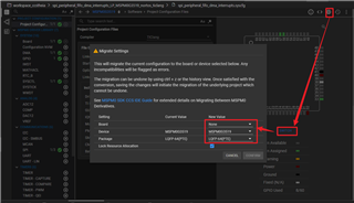

  • Hi Ken,
    If you want to modify the MSPM0 devices you are using, I recommend you to use sysconfig tool to switch device, there are all MSPM0 devices options for you to switch. You could refer to 3 Software Development Instructions  of  MSPM0 MCUs Development Guide (Rev. F) for development tool setup.
    The analog configuration is designed for MSPM0 launchpad for some basic evaluation of MSPM0 analog function, so it does not support to switch to other packages. You could evaluate on the launchpad firstly, and then develop you firmware based on SDK and Sysconfig for your customer board.

  • We're past the point of 'evaluation', and made a plug-in to serve as proof of concept based on the Launchpad.  In other words we are already "hardwired" by a PCB to use COMP1-IN1+
    I will go back to CCS configurator and review (I admit I'm new), but was unable to get the Analog configuration at the level of detail provided by the analog configurator.   I couldn't find where the CCS configurator allowed OP-AMP buffers before the A2D.
