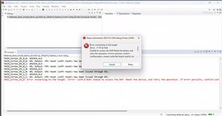

I'm trying to work "ethercat_slave_simple_demo_am243x-lp_r5fss0-0_freertos_ti-arm-clang".
I could build this project under CCS12.7. So, I will try to deploy this on LP-243x via XDS110 onboard debugger.
However, as I launch target configuration file, I got following error.
"Error connecting to the target: (Error -1170 @0x0)
Here is capture image.

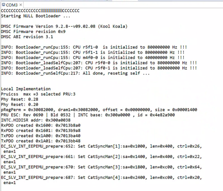

    >Are you able to see the SBL logs on UART console once the EVM setup is done?
    Yes. Here is console log on CCS.
    Looks like the EVM is initialized correctly. Can you please disconnect and reconnect the JTAG cable and try again?

    Here is my result when I performed "test connection".

    Here is procedure how I got application log.
       - POWER-OFF the AM243X-LP
       - Switch the LP boot mode to OSPI mode.
       - Connect the UART terminal
       - POWER-ON the AM243X-LP
       - Close the UART terminal
       - I saw output below on the UART terminal
      - I peformed debug by clicking following icon (build project and launch debugger.)
      - During launching debugger, I saw "cortex M3" connection error as I posted on previos thread.
      - After confirming above error, I checked console. Then, I saw following application log.
