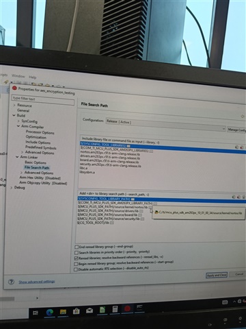

  • Hi Nikhil,
       As per the instructions in the video, I started writing the command under the js section. However, it's throwing an error saying that some file in the am263p-cc folder is missing, even though the files are actually present. I'm stuck at this point.
  • The path shown in the script in C:/ti/mcu_plus_sdk
    Have you installed the SDK under this name? If not, can you update the path in the .js file?

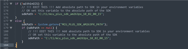

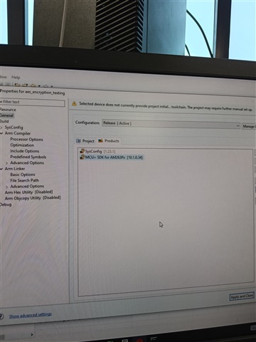

  • Hi Nikhil,
       I have mentioned correct paths under products section as shown below. Can you update me where to change path in .js file?
  • In the .js file,
     Modify "sdkPath" (search for EDIT THIS) to point to the absolute path of the SDK.
    - On windows make sure to use '/' or '\\' as path separator
    Thanks and Regards,
    Nikhil

  • Please update the sdkpath as shown below in the load_sbl.js file
    And please build the sbl_null example in the SDK using below command, before running the .js file
    cd ${MCU_PLUS_SDK_PATH}
    gmake -s -C examples\drivers\boot\sbl_null\am263px-cc\r5fss0-0_nortos\ti-arm-clang all
    or u can use CCS as well to build this SBL
    Thanks and Regards,
    Nikhil Dasan
