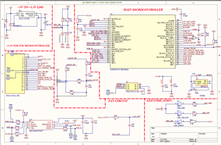

  • Hey all,
    Below is the schematics with the MCU.

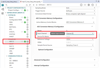

    Sorry, I was out of office before, let me continue to follow up the case, I hope you can try the following two steps to make it easier for us to synchronize the problem on both sides.
    1. Since now you have used only one channel to do the test and still face the same issue, could you please try to use the example(adc12_max_freq_dma_LP_MSPM0G3507_nortos_ticlang) in our MSPM0-SDK to test it on your board? Just modify the input channel in the Sysconfig as shown below and then download into your board to see if the issue still exist?
    2.  Could you please use both your code and the code provided in the SDK to test the internal temperature sensor(ADC0 Channel 11) to see if the issue still exist in these two codes?
    Peter
