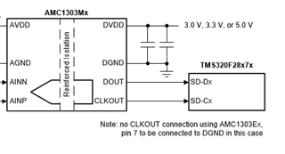

I am trying to run the SDFM EPWM sync CPU read example on my tmdscncd263 control card.
Running CCS Version 20.1.1 (20.1.1.466), MCU SDK - mcu_plus_sdk_am263x_10_01_00_31. I am running the imported project without modification.
I have a single AMC1306EVM I am powering and sourcing to D0. I have confirmed this IC is working as I can see DOUT output a digital signature when using the PWM waveform as a clk source (see below).
I have 3 problems on this project:
- Where I am seeing DebugP_log messages in CIO from other imported projects, I am not seeing them from running this project.
- I can see some DebugP_log when running `screen` locally, but i never see the startup messages
- DebugP_log("SDFM EPWM Sync CPU Read Test Started ...\r\n");
DebugP_log("Please wait %d seconds ...\r\n", APP_RUN_TIME);
- I do see the following from `screen
- SDFM ISR count: 0
Modulator failure - (repeat)
- SDFM ISR count: 0
- When attaching a scope to HSEC Pin 72 (SDFM0_CLK0), I don't see any waveform.
- It does not seem like the clock is correctly enabled in the example code.
- I do need the output clk working, I cannot rely on a PWM output as the clk source.
- If I plug the ePWM HSEC Pin 51 output into my SDFM AMC1306EVM as the clock source, I do see the SDFM IC output a digital signature on DOUT.
- But the Sitara does not seem to receive the D0 data result or process it.
- The sdfmISR1 function does not seem to ever trigger (confirmed by using a breakpoint during debugging).
- Is this a result of the int_xbar not configured?
And a quick observation
- The clock sources for SDFM_FILTER_2, 3, 4 are configured but it does not look like 1 is. Is this done on purpose? If so why?
- Note, I have added a line configuring SDFM_FILTER_1 and it does not solve my issues above.
