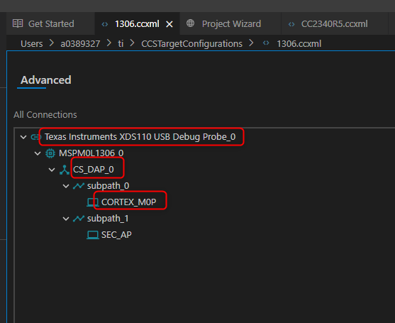

I know the root cause. I add more than one core in the test_server.js. The source file is from simplelink, BLE.
Another question is that do you know where I can find the core information? I can't find the MSPM0 info in this link:https://software-dl.ti.com/ccs/esd/documents/users_guide/sdto_dss_handbook.html#multiple-debug-sessions-for-multi-core-debug
Ah ok, you were sending the command to the DAP and not the M0.
Are you referring to the name of the cores? You can get that from the ccxml file:
