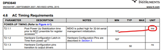

Other than simply waiting a little bit , Is there a recommended way (through status registers, hardware mechanisms, or proven techniques) on the TMS570LC4357 or DP83640 to directly detect the presence of the MII clocks from the PHY before initiating any EMAC transfers? It appears that the DP83640’s MDIO interface and responses become available even before the MII clock outputs are fully stabilized.
