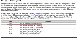

    The status_check function is used by our host to detect whether the Target has entered the BSL. You can send any data except 0x80. If the Target enters the BSL, it will be judged as an error frame and return 0x51 if it receives data other than the frame header (0x80). And we will judge whether response is 0x51
