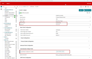

    2. Is there an example code for such 8D-8D-8D DDR PHY tuning? (I need at least a frequency of 80 MHz in my application)
    Yes, OSPI_FLASH_IO example in  mcu_plus_sdk_am261x_10.2  has PHY enabled by default enabling to operate at 166MHz DDR. So you can just use the "Load from JSON" feature in SysConfig to make the example run for IS25WX256 flash part.
    Please follow the below steps:
    1. Import a new ospi_flash_io example from mcu_plus_sdk_am261x_10_02_00_15 path:  C:\ti\mcu_plus_sdk_am261x_10_02_00_15\examples\drivers\ospi\ospi_flash_io\am261x-lp
    2. Open example.sysConfig in the project
    3. Navigate to TI BOARD DRIVERS ---> FLASH
      1. Change the Flash name to IS25WX256
      2. Change the protocol to 8D-8D-8D
      3. Click on "Load from JSON" button and load the flash json IS25WX256.json file the below path:  C:\ti\mcu_plus_sdk_am261x_10_02_00_15\source\sysconfig\board\.meta\flash
    4. Rebuild the example and run

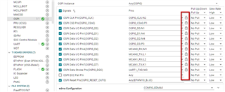

    Also as a more generic approach please try the below steps:
    1. Lock all the OSPI pins/signals in sysconfig
    2. Expand the PHY Tuning window parameters to MAX range i.e: 0 - 127 as below
