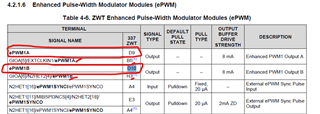

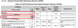

From TMS570LC4357 HerculesTm Microcontroller Based on the ARM® Cortex®-R Core:
Just for reference, I have also configured pin E3 for ETPWM1SYNCO.
From the TMS570LC4357 HerculesTm Microcontroller and Development Kit documentation, I can't see D9 and D10 configured for PWM1 in the HDK User's Guide.
Could the issue be that the Hercules Development Kit (HDK) does not support D9 and D10 for PWM1? If so, will the TMS570LC4357 IC itself support PWM1 on these pins?

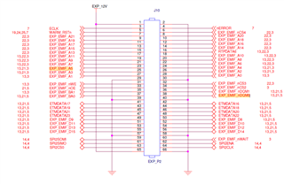

  • Hi Vijay,
    I verified TI_HDK schematic of TMS570LC4357
    Here i found that D9 and D10 are not terminated out, i mean they are not routing to any connector. So, where exactly you are tapping and verifying these signals?
    There are some wrong names for the pins in schematic file, please refer below schematic file, here i wrote correct names for pins:
    5734.TMS570LC43_SCHEMATICS_REVE.pdf
    So, i think it is not possible to directly test these pins for PWM generation. So, make sure you are tapping correct pins.

  • Over J10 connector of TMDX570LC43HDK development kit I see D9 and D10 pins from that connector I was tapping the pins.
    But from TMS570LC4357 HerculesTm Microcontroller Based on the ARM® Cortex®-R Core:
    PWMA is deafults for D9 and 10 pins, But from TMS570LC4357 HerculesTm Microcontroller and Development Kit documentation,
    So can we conclude that Hercules Development Kit (HDK) does not support D9 and D10 for PWM1?

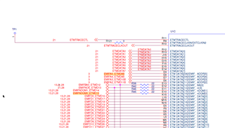

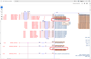

  • Hi Vijay,
    Our apologies for the confusion.
    You are correct D9 and D10 are not terminated.
    The D9 mentioned on the board is actually E9(EMIF_A5), and similarly D10 mentioned on the board is actually E10(EMIF_nDQM0):
    I highlighted D9(J10-23) and D10((J10-38)) mentioned pins in schematic:
    As you can see, they are actually E9 and E10 in schematic:
    Particularly this TMS570LC4357 HDK board have some typo errors in user guide and schematic, i will note down these errors and will push to rectify it in new version.
